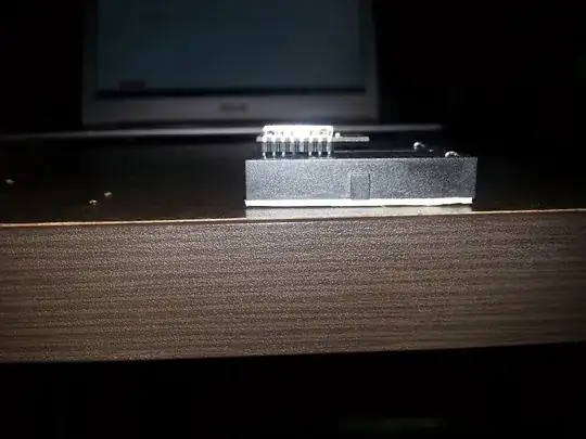

You can use 2mm pins to connect the device to 2.54mm breadboard , not all pins are in total of 16 pins 3 are out but they not needed for my purpose(link to product in comment) :
