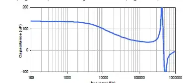

I do not like using dry tantalums for a number of reasons; They are prone to failure simply due to reflow even when properly derated and with a low impedance source (which is what the power supply is) they can become spectacularly pyrotechnic. In addition, they have effectively zero capacitance above perhaps 400kHz (so if you need decoupling above this frequency, tantalums are no use anyway).
Tantalum Frequency response
