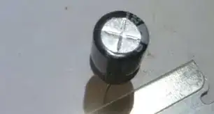

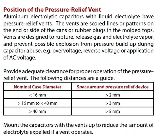

Large capacitors are less spectacular than small ones, because they always have some kind of vent. Often these days, it's in the form of scores in the aluminum can which weaken it so it will fail in a fairly predictable fashion in case of internal overpressure. Top vent:
Typical manufacturer's caution on vent clearance:
