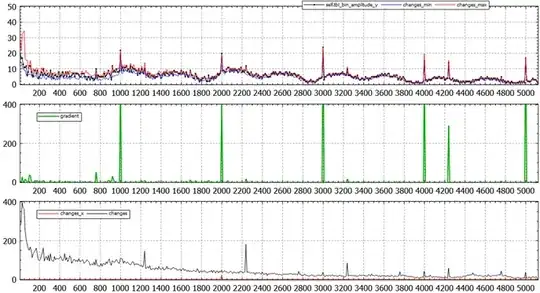

In this Micropython project I wanted to build a cheap/small sound spectrum analyser to identify specific tones during testing. Initially I tried to connect the Adafruit sound sensor with an ADC and RPI but then faced a lot of timing problems and therefore went to the ARM-M4 micro-controller which is a pretty good straight forward solution. On git-hub I found an FFT code written in ARM assembler by Peter Hinch, which allowed me to obtain on-board frequency spectrum calculation of an array, based on the Cooley-Tukey algorithm.
micropython+adafruit
The picture below illustrates the spectrum(top) in a silent room, the middle plot shows the calculated gradients of the domain and the last the reactivity of the specific tones. The system is continuously captures 2**10 samples in 0.1s >10Hz-5kHz, calculates the FFT and forwards output array to PC in 15ms.
Sound spectrum 10Hz-5kHz
The problem is found in the harmonic tones that appear at exactly 1,2,3,4,5,.. kHz (graph was taken in silent room). Second problem shows up when there is a little more noise; spikes(bottom graph) appear around the harmonic tones+/-240Hz, aliased?. The bottom plot shows the reactivity of the tones.

What is most likely the cause of this behaviour? Board circuit / Electret-Amplifier / FFT-code / USB-power?

  • You might want to capture some "raw" data and investigate it yourself to see if these tones are in the data or an artifact of your fft implementation – PlasmaHH Jun 21 '16 at 11:55
  • It's likely real – Scott Seidman Jun 21 '16 at 12:08
  • Doesn't the RaPi contain a (miniature) switching power supply? And likely your PC also contains one. (But the fact that it is on exact 1 kHz points is a little suspicious...) Maybe the PLL feedbackloop of your RaPi CPU clock could be a source. – Wouter van Ooijen Jun 21 '16 at 17:34
    What is the sampling frequency? I can tell that it's above 10kHz somewhere. Do you have an analog anti-alias filter below your Nyquist frequency? If not, could those spikes be aliased? Maybe from ultra-sonic frequencies? – Mark Jun 21 '16 at 17:34
As you noted, and the third plot accentuates this, the spacing is always very close to 1 kHz, but just offset by something like 240 Hz. This is indicative of an alias signal. It would be against a harmonic of the sample rate (guessing to be 10 kHz). I'd get a broadband scope if possible and put a loop of wire on it ( a circle a couple of inches in diameter) to "sniff" for signals. The signal might be from the board, or it might be from your monitor, the PC power supply, an LED or fluorescent bulb or anything with power.
