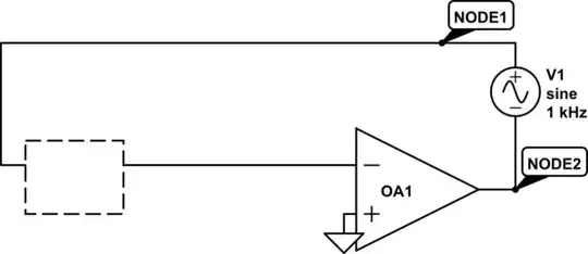

ConfusedCheese, here is a simple method for simulating the loop gain for an operational amplifier with feedback. This simulation scheme provides DC feedback and a stable operational point (for double and symmetrical voltage supply only!).
  • The dashed box contains the feedback factor, if any!.
  • Without this box (direct connection to the inv. input) you simulate the open-loop gain Aol of the opamp only.
  • The loop gain is simply T(s)=V(node2)/V(node1). Of course, the frequency must be swept over the desired range (ac analysis).

  • For simulation, the method as shown in the figure above can be used. For real measurtements, this NOT possible and a somewhat more complicated feedback arrangement must be used. For stability analyses it is NOT necessary to plot the opamps gain and the inverse feedback factor separately. You can, from the beginning, plot the loop gain of the whole loop (under open conditions) because the stability criterion applies to this gain of the open loop only. – LvW Jun 20 '16 at 15:47
  • @ConfusedCheese The method described by LvW is a semplified version of a well-known method to find the loop-gain developed by Middlebrook, and described in this paper. The semplification works when you connect the voltage source (V1 in the schematic above) to a low-impedance node, like the output of an op amp. In the more general case, the method requires two injections, a voltage injection and a current one. – Massimo Ortolano Jun 20 '16 at 18:36
  • Yes - Massimo Ortolano, you are right. It is a special version of the Middlebrook method. In this case (low impedance node at the opamp outpt) a current-injection is not necessary. But again: It works for simulation only (because of the floating voltage source). – LvW Jun 20 '16 at 18:55
