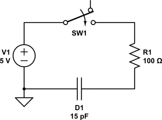

In a very technical, nit-picky kind of way, yes… sort of. The depletion layer of a reverse-biased diode has a capacitance. If we assume that capacitor is discharged at t=0, then some current will flow briefly as it charges to the voltage of the battery.
However, that capacitance is very small for most diodes. For instance, it's about 15 pF for a 1N4001 diode. If we assume a 5V source and a 100Ω resistance, this takes about 10 ns to charge; simulate the circuit below to see for yourself.
schematic
  • And of course that 10ns will not heat the filament to any appreciable temperature. ( however an LED may emit a 10ns burst of light) –  Jun 18 '16 at 21:44

  • I disagree, I think he understands that the diode will generally stop the current completely (as opposed to piling up). As the other answer has grasped, I think hes asking about the time in-between the voltage across the diode being 0, and the voltage being the battery voltage. – BeB00 Jun 19 '16 at 01:01
