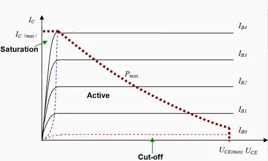

enter image description hereI understand base-collector (current) linear relationship is lost in saturation region and collector current will be lesser than \$ \beta * Ib \$ . Hence,at max, we can call such a region as non-linear region.
Saturation literally means something remaining constant and not increasing further (upon variation of another quantity). Which quantity is getting saturated in so called 'saturation region' of BJT ?
Obviously the collector current. It can be seen very clearly from the output characteristic graph that as you decrease the collector to emitter voltage, the corresponding current increases with reference to the DC load line. When the voltage becomes very less the collector current starts to saturates (not increasing any more for irrespective of the variation in voltage between collector and emitter.)

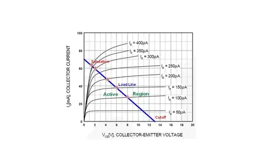

I think this can be explained only after considering the effect of load line. As it is evident from the figure shown, a change in base current causes a negligible change in collector current in the saturation region. Whereas in active region , it causes a linear change.
Hence collector current is the one which gets saturated upon changes in base current.
Learning(sounds silly!): It is a bad idea to understand transistor operation from characteristics itself. Always understand the effect of load line (external circuitry) for any any realistic operation.
