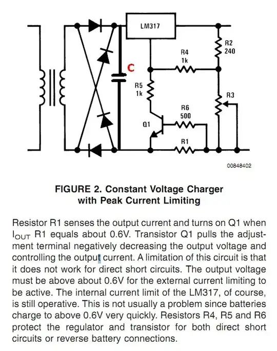

A good, easy and cheap (choose any 3) solution is in the Useful LM317 battery charging application note that @mindcrime referred to.
Their fig 2 does what you want albeit somewhat crudely.
The LM317 sets the output voltage and Q1 and R1 etc limit max current.
Be sure that your brand of LM317 will supply 1.5A. It varies.
Changinge the LM317 to an LM350gives more current.
Note that this circuit needs to be fleshed ou t - eg a filter cap where I show and one at the output and maybe one on the reference pin.
See LM317 datasheet.

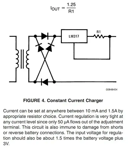

Even easier is to use an LM317 in constant current mode, as in their fig 4, thusly
And THEN follow this with an LM317 based 7,7V supply. Note their comment on required Vin.
Total solution takes 2 x LM317 + resistors + capacitors and it does exactly what you have asked for.
