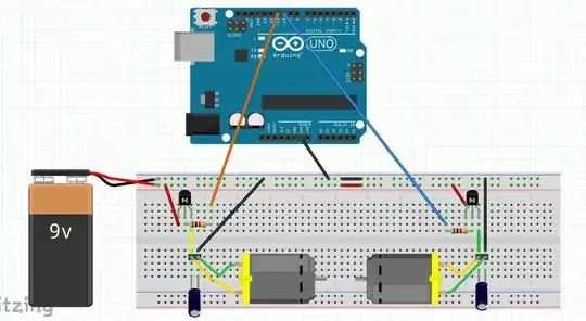

The transistor gets hot to the touch and the motor will continue to run when I disconnect the transistors base from 9v+ (I am trying to make sure the circuit works before I hook it up to an arduino). The motor will continue continue unless I disconnect the power supply.
Is this how the circuit is supposed to work like this? I am using a 9v power supply, simple toy motor, 1uf cap, 1k resistor, and a PN2222a npn transistor.
I was following this instructables (http://www.instructables.com/id/Simple-Cheap-Motor-Driver-Board-for-Arduino/?ALLSTEPS). What am I missing with this circuit? Should I go through and do all the calculations for the circuit? Thanks!!! enter image description here

    What you are missing with this circuit is a circuit diagram. Cartoons don't help at all. – Andy aka Jun 10 '16 at 09:15
First, you need to learn how to read and draw schematics. Fritzings are terrible to work with.
With that said, your circuit was never going to work. The circuit is bad. The voltage delivered to the motors will be low.

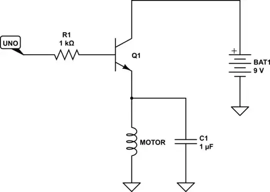

Let me show you what you have
schematic
This will only work for a (about) 3 volt motor. Depending on how much current the motor draws it may also cause the transistor to get very hot. "Simple toy motor" is not remotely a motor specification which is useful.

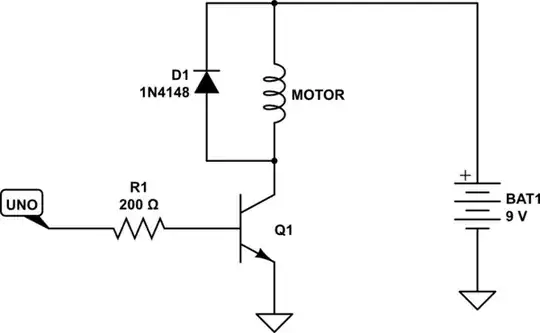

What you need is
schematic
simulate this circuit
Note that the resistor has been changed to a lower value. This may or may not be necessary, but you haven't stated the motor characteristics.
This also assumes your motors will operate well on about 9 volts. You can check this by simply connecting a motor across your battery. If it works and doesn't overheat, you know the motor is OK.
