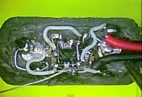

The Solution Revealed!
Hackaday summarizes:
it uses two AC power sources, diodes, and inductors. In contrast to every single guess about where the circuit is hidden, the majority of the build is inside the battery connector. [Fredzislaw] did some amazing work hiding a 74LV132 quad NAND Schmitt trigger inside the battery connector. The diodes were easily hidden on LEDs 1 and 3 with some red nail polish, but we’re amazed by the inductor built into the LED seen in the title pic.
And two shots from the video, showing the circuit diagram and how it's embedded in the battery connector:

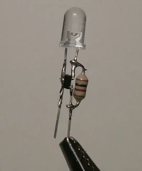

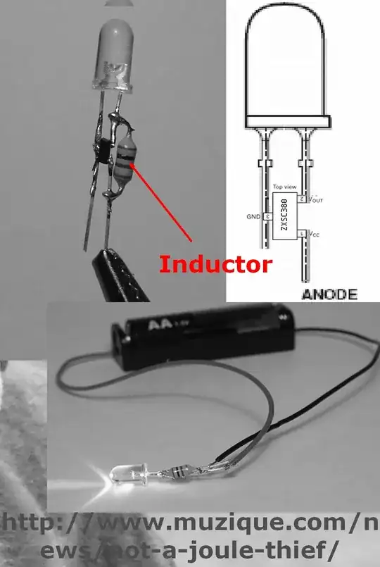

Inline LED driver
While this by itself does not fi=ully answer the problem it shows what can be done: enter image description here
http://www.muzique.com/news/not-a-joule-thief/

    Each LED contains a window comparator and current bypass circuitry: Are there LEDs like that that seem like in the video, or are you just saying "if there were"? – abdullah kahraman Dec 20 '11 at 10:27
    An excessively enthused magician may make devices that look like LEDs but have extra circuitry. That's only one option. Doing so as shown is entirely possible but seems like too much work. Video fakery is the most likely option. Induction through the table in some manner is possible. Contacts somehow are also possible. | He presents it as science and engineering but its actually stage magic. That makes him a liar and a cheat as he will confuse learners with his lies. I have commented "robustly" on his video. I wonder if he will respond. | I cold do something equivalent if paid to do it :-). – Russell McMahon Dec 20 '11 at 11:30
