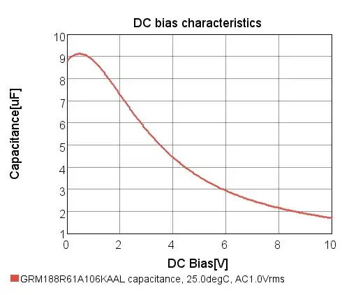

Ceramic capacitors also have a characteristic loss of capacitance with applied DC bias. For instance, the capacitance versus DC bias curve of the Murata GRM188R61A106KAAL# device is:
Murata GRM188R61A106KAAL capacitance versus DC bias
From the interactive chart, at the typical 3.3V operating input, this specific capacitor only has an effective capacitance of 5.337uF, a loss of almost 50% of the rated capacitance at under half of the rated DC bias. While the bulk capacitance of this application does not require a specific value, this can be a "gotcha" for applications with a minimum capacitance requirement.

  • Your graph is absolutely horrible! I'm looking to bypass an op amp at +/- 15V. A typical by passer is 100nF. Is this bias derating common to all ceramics, or just your small SMT type? Do we just have to use 100V rated ceramics for old level voltages instead? – Paul Uszak Jan 01 '17 at 14:29
    @Paul: This answer is misleading in that it picks a particularly extreme part and implies it serves as a general example. Capacitance decrease with voltage certainly exists, but there are also many cheaply available parts that react much better than what is shown. This is not common to all ceramics or SMD capacitors. It is a function of the ceramic. For high-volume non-exact use, like bypassing, it can be worth the little extra savings to use cheap ceramics. Better ceramics aren't that much more money, and you can also compensate by using a higher starting capacitance in some cases. – Olin Lathrop Apr 29 '17 at 13:32
