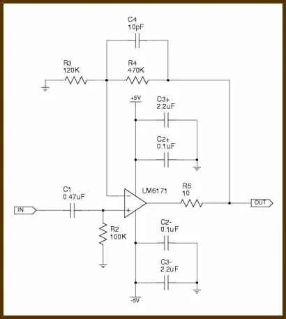

Many experts here recommend 100nF bypass caps to the power rails of an op-amp. I made it a tradition myself that when I use any op-amp I always use 100nF decoupling cap from +Vcc to GND and -Vcc to GND.
But I also see different variants as below examples:

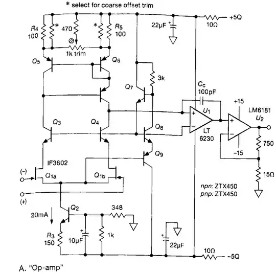

As you see above examples do not just use 100nF at the power rails but either RC like lowpass filters or two caps in parallel.
Does that matter which variant I use for the power rails for decoupling? Is there a principle or rule of thumb? What should be the criteria?
Note: This is a question specifically only about bypass caps at power rails of an op-amp. I couldn't find a specific satisfactory answer at related questions.

  • @dim But what about the opAmp examples in my questions. They use an RC filter or two caps in parallel instead of a single cap. When I implement a circuit what should I ask myself to determine which variant I should choose among them? – user16307 May 29 '16 at 19:37
    That's right, the RC filter is a more specific case, that JIm Dearden's answer explains well. Not a duplicate, after all... – dim May 29 '16 at 19:46

Another purpose is to filter out some AC interference or similar voltages found on supply rails. To get this effect, you need to use ferrite beads (or resistors) between the power rail and OP AMP. Resistors are not a good choice as they increase voltage drop on DC.

The purpose of the capacitors at the rails is to decouple (smooth out or short out) any AC from DC.
0.1 or 100nF is generally used to smooth out the higher frequencies and transient edges (glitches) that might find their way to the output of the op amp.
Sometimes it is important to ensure that the lower frequencies (such as 50Hz) are eliminated or substantially reduced . In this case a large value (usually electrolytic) capacitor is used, sometimes with a small series resistor to give the smoothing required.
Why not just use one larger capacitor rather than two?
Larger values tend to have a greater loss at the higher frequencies (become more resistive/reactive) so by placing two different (types of) capacitors in parallel (say 10uF, 0.1uF) it increases the effective frequency range of the decoupling.
JIm Dearden
