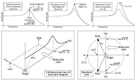

When damping is added, the natural frequency stays the same but it can (eg for a low pass filter) rotate anticlockwise in the pole zero plane and this leaves (in the jw axis) what is known as the damped resonant frequency, \$\omega_d = \omega_n\sqrt{1 - \zeta^2}\$. See lower part of 1st set of pictures below (it's basically Pythagoras and right-angle triangles).

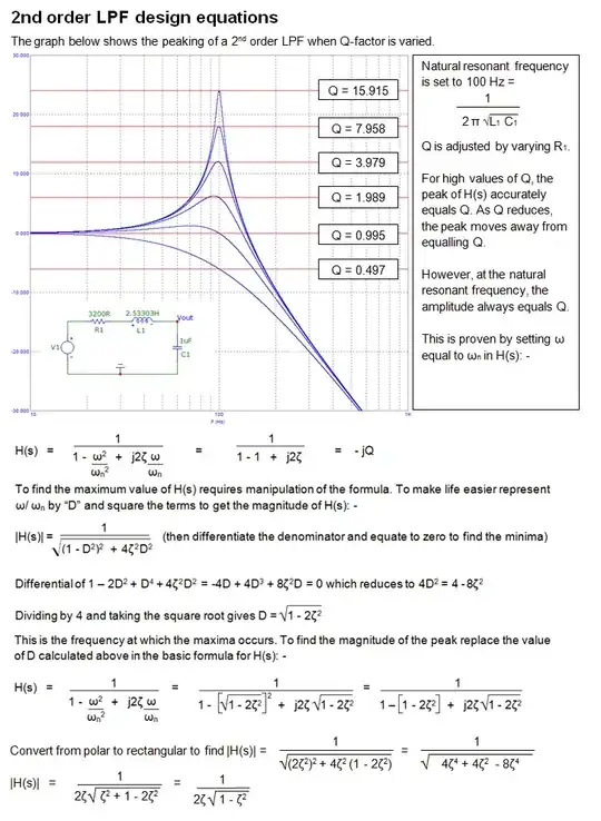

And for low pass filters, there is the frequency at which peaking occurs and this is slightly different to damped resonant frequency, \$\omega_p = \omega_n\sqrt{1 - 2\zeta^2}\$.
The amplitude that this peaks at is \$\dfrac{1}{2\zeta\sqrt{1-\zeta^2}}\$
The proof of these three different frequencies for a low-pass filter is relatively straightforward but a little long winded. Below is an extract of a design paper for a 2nd order low pass filter where it is shown that a varying Q-factor moved the "peaking" frequency away from the natural frequency (100 Hz in this example) but, as always Q is the value of the peak at the natural resonant frequency: -
Maybe a close up view will be more exciting: -

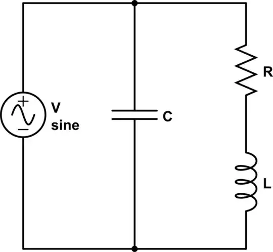

Consider the following circuit:
schematic
The admittance as a function of \$\omega\$ is: $$Y(\omega) = j\omega C + \frac{1}{R + j\omega L} \\ = j\omega C + \frac{R - j\omega L}{R^2 + \omega^2L^2} \\ = \frac{R}{R^2 + \omega^2L^2} + j\left(\omega C - \frac{\omega L}{R^2 + \omega^2L^2}\right)$$
As you can see, $$\operatorname{Im}(Y(\omega)) = \omega C - \frac{\omega L}{R^2 + \omega^2L^2}$$
Thus, the equation for the "damped resonant frequency" \$\omega_d\$ will be $$\omega_d C = \frac{\omega_d L}{R^2 + \omega_d^2L^2}$$
The solution is $$\omega_d = \sqrt{\frac{1}{LC} - \frac{R^2}{L^2}}$$ Define natural (undamped) frequency as $$\omega_0 \equiv \frac{1}{\sqrt{LC}}$$ Then we can rewrite the solution $$\omega_d = \sqrt{\omega_0^2 - \frac{R^2}{L^2}}$$
This is where so called natural (or undamped) resonant frequency pops up. As you can see, if \$R = 0\$, then \$\omega_d = \omega_0\$.
