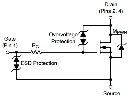

In fact, while researching MOSFET protection I came across this integrally protected product that includes in its features "internal series gate resistance," as shown on its diagram:
Protected MOSFET circuit
If this idea is correct, then the question is: Why not always put a megaohm resistor before the gate of any FET?
Or is there a practical reason that a gate resistor would not typically protect the FET? Or could it even have any adverse performance effects?

    Note that the RG you show is useless as a protection mechanism unless the second pair of (zener) diodes is also present. It is voltage that destroys the gate isolation, not current. – Wouter van Ooijen May 11 '16 at 17:36

  • "it also protects the one whos driving the mosfet" - I would say that, in fact, it protects the overvoltage Zeners, and possibly whatever sits at the drain. – JimmyB May 12 '16 at 16:24
  • In the datasheet, this resistor is considered as a feature:"Internal Series Gate Resistance". This mosfet is intended to operate with low voltages with Rds ~150mOHM at 4V. The feature means that the user can drive this mosfet directly from a low-current driver such as a microcontroller output pin buffer. Your absolutely right that it also protects the zener and limit the current to the drain when clamping. – fhlb May 13 '16 at 09:30
  • You're right. The R also protects the IO pin from overvoltage at the drain! – JimmyB May 13 '16 at 09:51

Edit: Re-interpreting the value shown on the datasheet. The resistance shown is not M\$\Omega\$, much lower, more like 3400 ohms based on the change in the switching times with external gate resistor.
This does in fact really slow the switching when the gate charge is high, such as the 1.6ms minimum off switching time with a 15V 1.5A load. The asymmetric switching time implies they may actually have a diode across the resistor to speed the 'on' time. The diode will be reverse-biased when clamping, as explained below.
A large value resistor will not likely protect the gate anyway, it's a permanent breakdown and insulation damage that occurs, not like a diode breakdown. That's why the ESD zener diodes are on the gate lead, to prevent excessive gate-source voltage.
So, why put any resistor at all in there you ask? Well it's so the other (Overvoltage) zeners can do their thing. Imagine the worst case and we short the gate lead to the source, and then sadistically increase the voltage on the drain (through some external load) waiting for the D-S breakdown. When the current through the zener diodes exceeds some mA the MOSFET turns on and clamps the overvoltage.
Power MOSFETs are generally not very sensitive to ESD anyway, because of the large gate capacitance. The gate actually breaks down at something like 50V-100V typically so a lot of energy has to reach the gate. Tiny MOSFETs such as RF MOSFETs are very sensitive to ESD in comparison. However, the typical human body model of ESD is enough to damage even a moderately large power MOSFET gate.

However, to be clear that is absolutely not what the resistor shown is included for - as others have noted, that is there to keep the clamping Zeners in the safe operating region. Also, note that slowing down switching edges has negative effects (increased thermal losses at switching edges being one) on circuit performance - as such any use of this technique is a compromise.
