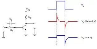

  • (2) Connect a small capacitor in parallel with the resistor.
    This is known as a "speedup capacitor".
    Sounds good :-). Better for on than off but has a role both ways.
    It helps to "sweep charge" out of the base emitter junction capacitance on turnoff and to get charge in there on turn on. As per example below from here. This page is VERY worth looking at.
They note (more worthwhile material on page)
  • Reducing storage time. The biggest overall delay is storage time.
    When a BJT is in saturation, the base region is flooded with charge carriers. When the input goes low, it takes a long time for these charge carriers to leave the region and allow the depletion layer to begin to form. The amount of time this takes is a function of three factors:
    • The physical characteristics of the device.
    • The initial value of Ic
    • The initial value of reverse bias voltage applied at the base.
  • Once again, we can't do much about the first factor, but we can do something about the other two. If we can keep just below saturation, then the number of charge carriers in the base region is reduced and so is . We can also reduce by applying a high initial reverse bias to the transistor.
    Fall time. Like rise time, fall time () is a function of the physical characteristics of the transistor, and there is nothing we can do to reduce its value.
    Putting all these statements together, we see that delay and storage time can be reduced by:
    Applying a high initial value of (to decrease delay time) that settles down to some value lower than that required to saturate the transistor (to reduce storage time). Applying a high initial reverse bias (to reduce storage time) that settles down to the minimum value required to keep the transistor in cutoff (to reduce delay time). It is possible to meet all of these conditions simply by adding a single capacitor to a basic BJT switch. This capacitor, called a speed-up capacitor, is connected across the base resistor as shown in Figure 19-7. The waveforms in the figure are the result of adding the capacitor to the circuit.
    When initially goes high, the capacitor acts like a short circuit around. As a result, the input signal is coupled directly to the base for a brief instant. This results in a high initial voltage spike being applied to the base, generating a high initial value of . As the capacitor charges, decreases to the point where is held just below the saturation point.
    When the input first goes negative, the charge on the speed-up capacitor briefly drives the base to –5 V. This drives the transistor quickly into cutoff. As soon as the capacitor discharges, the base voltage returns to 0 V. This ensures that the base-emitter junction is not heavily reverse biased. In this way, all of the desired criteria for reducing switching time are met.

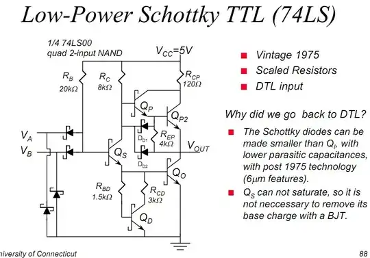

LSTTL & even faster friends:
Warning !!!!!!!!!!!!
Looking in here whence the below diagram came from, is liable to result in you and your soldering iron and/or breadboard staying awake all night :-).
Many good ideas.
Can you do a Miller killer ? :-).
Note that low power Schottky uses Schottky diodes whereas the earlier Schottky TTL used Schottky transistors - an apparent step backwards.

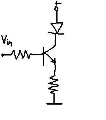

I suppose your problem is, that your BJT is saturated when switched on. This means the current going through the collector is NOT limited by the control current going through the base but by the current limiting resistor in the collector path.
I.e. with the same base current the transistor could admit more current going through the collector.
If this is the case, the turn off time of the transistor will be relative long (if I remeber right, the reason is because then charges in the base region will be swept out mainly by diffusion which is a rather slow physical process).
You can change this situation easily by following circuit:
Now the current going through the emitter (which is only slightly more than the one going through th collector) will raise the emitter to a level that makes the base current just small enough that it will be the limiting factor of the current going through the collector. So the transistor wont be saturated any more and will turn off quicker.
There is also another advantage of this circuit:
This circuit will be more stable when the transitor heats up and becomes more conductive (semiconductors become MORE conductive when heated). The current wont change much (in your first circuit it will).
Be aware that the current now doesn't depend on the supply voltage, but on the control volatge (Vin).
EDIT1:
Let be
Rb resistor at base (may be a small value; even 0 Ohms)
Re resistor at emitter
Vbe base-emitter-voltage (ca. 0.7 V for Si transistors)
b current amplification (ca. 50..100)
Ie = b*Ib emitter current; almost equalt to Ic = Ie - Ib
Vin = Rb * Ib + Vbe + Ie*Re
Solve for Ie:
Ie = ( Vin - Vbe ) / ( Rb/b + Re)
Rb/b will be very small; can be negelegted, so
Ie = ( Vin - Vbe ) / Re
EDIT2:
I did some real world measurements of both circuit variants:
The left version is the one with the saturated transistor (A).
The right version is the one with non-saturated transistor (B).
In both variants the switched current is about the same.
But now look how long it takes to turn off the current in (A):
ca. 1.5µs between the edge of CH1 (base voltage; blue) and CH2 (emitter current; green): enter image description here
...and in (B):
almost no delay between the edge of CH1 (base voltage; blue) and CH2 (emitter current; green): enter image description here
