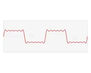

By Lucas V. Barbosa - Own work, Public Domain, https://commons.wikimedia.org/w/index.php?curid=24830373
For example, this square wave is made from the fundamental frequency, plus all its odd harmonics. That is, if this is a 1000 Hz square wave, then it's a combination of sine waves at 1000 Hz, 3000 Hz, 5000 Hz, 7000 Hz, and so on. For an ideal square wave these harmonics go on forever, but as they get higher they decrease in amplitude.
The frequency response of something (like a filter) describes how it will affect each of these sinusoidal components. In a linear system (as most filters are), it's valid to consider what would happen to each component independently, given the frequency response, and then add all the results back together to see the net result.
