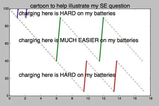

Below is a 'cartoon' of a plot to help clarify my question. Is cycling between the 90% and 100% points 'harder' on these types of batteries than an equal number of cycles between the 40% and 90% levels?
By 'harder' I mean a significant loss in battery capacity after (very roughly) 300 cycles, versus maybe 3,000 cycles.
Also, is cycling through the lower end (say 5% to 40%) also 'harder' than in the mid-range?

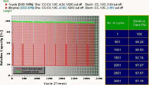

Here are some example plots from Kokam. For the 80% and 20% tests every 50th cycle was done at 100% (the vertical red lines) to check the full capacity.
At 100% charge/discharge the capacity dropped to 97% after 300 cycles.
At 80% it took over 1500 cycles. This is 5 times more cycles, but closer to 4 times improvement since only 80% capacity was available per cycle.
At 20% it managed 3000 cycles. This sounds impressive, but since only 20% of the full capacity was extracted it is equivalent to far fewer than 3000 full charge/discharge cycles. Depending on how the device being powered uses the available voltage and capacity, it may even be worse than cycling to 80%.
The main reason that a Lithium-ion battery 'wears out' is stress caused by expansion and contraction of the active material as lithium ions are squeezed in and out. Limiting the amount of charge/discharge reduces the expansion/contraction amplitude, which lessens damage to the plate material.

  • This is exactly what I was hoping for, thank you for taking the time to find data which is so graphic and quantitative and to summarize it so well! The distinction between number of cycles and total excursion in relative charge (%) is important to interpreting the data, and you've explained it clearly, along with the mechanisms and interplay of temperature, and of charge level during storage. – uhoh May 01 '16 at 01:47
  • Hmm...so it's not a constant total energy over the life of the battery. (simple sum of all charge/discharge cycles) If it were, then most of this would be moot. – AaronD Aug 11 '22 at 01:16
  • Also, I think the graphs are misleading. At first glance, it looks like they're discharging the battery to 80% or 20% remaining, denoted by the red line, when they're actually testing the top 80% or 20% capacity and leaving the rest. – AaronD Aug 11 '22 at 01:18
