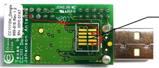

I also have an evaluation board (the CC1110-CC1111DK) to program the evaluation module, also with a 2x5 header. (The dongle is in the lower left) below:
Board photo

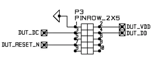

The addition here isn't hard - you've got a large debug header to hit. The pinout of this header is:

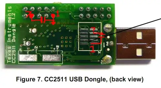

You can very simply add a small cap here between pin 1 and pin 7 to filter the noise. Either of the below locations would work:
Before adding an inline filter or cutting this trace, just add the 1nF cap described in the filter. Hit the indicated pins with a bit of flux, touch the leads of a through-hole cap to them, and solder away. If that doesn't solve your problem, add a pullup to Vdd (pin 2), and hope for the best.

Since you don't want to solder to thin traces (it's no fun), just cut the trace on the top of the board (as indicated here by the red arrows, ignore the added resistor) and then work on the back side. Solder a through-hole 2.7k resistor from the now-isolated pin 7 on the debug connector to the SMD debug header, and add the cap to the SMD debug connector.

  • @David - $50 may seem like a lot, but hacking on evaluation modules is quite normal. Start small (find some junk PCBs to practice on) and you'll get used to this. If you really mess something up, worst-case, you can revert it by jumpering together the through-hole pin 7 and the alternative debug header's pin 7 (see Figure 7). Actually, that might be an easier way: cut the trace on the top, and connect your resistor to the alternative debug header's pin 7! Much better, in fact. None of that pesky soldering to traces... – Kevin Vermeer Dec 02 '11 at 22:32
  • @David - Edited to demonstrate new method – Kevin Vermeer Dec 02 '11 at 22:39
  • A new wrinkle: my dongle seems to have a smaller-pitch header (not the standard 2.54 mm) already attached to the alternative debug pads. See photo. With the right connector and a ribbon cable, I should be able to wire it to my breadboard. Is there a name for this kind of small connector? Thanks again for all your help (and Olin, too). Our resident EE is in India until next year, so this is a life saver. – David Dec 02 '11 at 22:50
  • @David - Did your resident EE add that for you? I don't think they're populated on normal boards. Either way, it's just called a 'header'. You're unlikely to find a mate without knowing the part number, but to be clear: I'm not talking about wiring to a breadboard. I'm talking about soldering directly to these points on the back of the board. – Kevin Vermeer Dec 02 '11 at 23:04
  • Not sure. I took over this project from a former colleague, so it's possible he soldered it on. I'll email the EE and ask. I know the 2.54 pitch headers are pretty standard, so I thought perhaps the finer pitch header was another standard variety. And yes, I know you are talking about soldering. I thought I might breadboard it to see if it solves the problem before making it permanent. – David Dec 02 '11 at 23:09
  • @David - Breadboards have terrible parasitics. For this kind of filtering, breadboards are completely inadequate (See When to avoid using a breadboard for more info). If the filter was more complex, I'd suggest trialing it on a soldered protoboard before deadbugging it on the module, but in this case, the best way to test it is to solder right on the module; it's easy to remove this sort of thing. – Kevin Vermeer Dec 02 '11 at 23:14
  • OK, that's good to know about the breadboard. We have two other USB dongles, and I believe at least one has just the pads, and not the header, so I'll use one of those. I'll let you know how it turns out. – David Dec 02 '11 at 23:20
