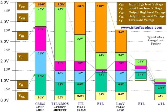

It's often said that 0's and 1's are represented by voltage, if the voltage is in the interval [0, 0.9), then it is a 0. If the voltage is in the interval [0.9, 1.5), then it is a 1 (voltages may vary, I'm only giving an example).
To some degree, you've mostly created this problem by using an unrealistic example. There is a much larger gap between logical low and high in real circuits.
For example, 5V CMOS logic will output 0-0.2V for logic low and 4.7-5V for logic high, and will consistently accept anything under 1.3V as low or anything over 3.7V as high. That is, there are much tighter margins on the outputs than the inputs, and there's a huge gap left between voltages which might be used for logical low signals (<1.3V) and ones that might be used for logical high (>3.7V). This is all specifically laid out to make allowances for noise, and to prevent the very sort of accidental switching that you're describing.
Here's a visual representation of the thresholds for a variety of logic standards, which I've borrowed from interfacebus.com:
Logic level thresholds][1]
Each column represents one logic standard, and the vertical axis is voltage. Here's what each color represents:
  • Orange: Voltages in this range are output for logical high, and will be accepted as logical high.
  • Light green: Voltages in this range will be accepted as logical high.
  • Pink/blue: Voltages in this range won't be interpreted consistently, but the ones in the pink area will usually end up being interpreted as high, and ones in the blue area will usually be low.
  • Bluish green: Voltages in this range will be accepted as logical low.
  • Yellow: Voltages in this range are output for logical low, and will be interpreted as logical low.

  • In your third bullet, I believe you have the colors or the logic switched. the pink should be low and the blue should be high. – Guill Apr 28 '16 at 21:41
  • @Guill Huh? The pink region is above V_T, so it will unreliably be treated as logical high. –  Apr 28 '16 at 22:02

But I never read what keeps electrical voltages "well-behaved" in a way that a 0 could never accidentally become a 1 due to electrical volatility1 inside the computer. Perhaps it's possible for the voltage to be very near 0.9, then what is done to avoid it passing the threshold?
Feedback is what prevents it from approaching the threshold voltage, and forces it to be well behaved.
This is usually in the form of a latching circuit of some sort, often a clocked latching circuit.
As a simple example, consider the flip-flop. It's designed so that the output is fed back into the logic circuit as an additional input. The logic within the element, therefore, knows what it's outputting and it will keep outputting the same value until the other inputs force it into the opposite state.
Since the circuit is designed so the transistors are fully on or fully off, then it will always output near the power supply and ground limits - it won't go near the 0.9v level, and when it does transition it will quickly and completely move to the other state. The circuits are designed specifically to avoid operating in the analog region between the two states.
