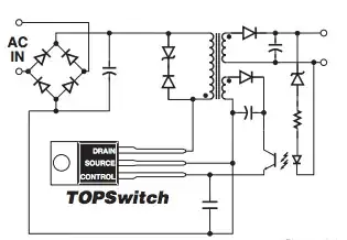

Case 2: You are trying to understand this simple switch mode PSU.
This is quite a simple circuit to understand but you will almost certainly want to look at the waveform across the IC drain-source which you can't easily do because the source of the device is not and can not be connected to earth. If you try you will almost certainly destroy the unit under test and your scope.
