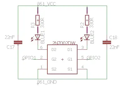

  • Included on the board are 2x dual n-channel mosfets driving 4 LEDs, the mosfets are there just to serve as a high impedance buffer (i think thats the correct term) incase any of the 4 I/O pins are also used to transmit data. Reading this post: Does my circuit need decoupling caps? The suggestion was made to also decouple the transistor and LED. Can and should the same principle be applied to a mosfet? The LED's are fairly low current, being driven at 2mA each so would a 22nF over the LED, series Resistor and mosfet D-S be sufficient?

Dual n-channel mosfet: enter image description here
