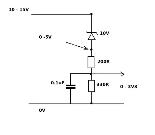

firstly apologies I'm a newbie at practical electronics!
I have a sensitive little thing which can measure 0-3.3v DC in steps of 0-1023. I'd like to use it to measure the voltage on a "12v" vehicle battery - which as I'm sure you know can go significantly higher when being charged through an alternator so really I need to figure out the following:
What circuit can I design to take a DC input of between... 10v and 15v... DC and bring it down to <3.3v in such a way that I can still measure the difference?

A simple way of doing this would be to use a series zener diode.
Below 10V the zener will not conduct and the output will be 0V.
Above 10V the zener will pass current into the voltage divider. This divider reduces the voltage (0 -5V) to give a 0 -3V3 output.
The .1uF across the 330R helps to filter noise.
The Zener current will be determined by the input voltage, zener voltage and the two resistors. In this case the maximum current will be 9.4 mA ((15 - 10) / (330 + 200))

  • Maybe a clamp diode to 3.3V? We're not sure if 15V is abs max – Wesley Lee Apr 17 '16 at 10:38
  • That looks like what I need! Now I need to find some cheap components, dig out a breadboard, try it out and the if it works find some way to connect it all to my microbit! – Oli Howson Apr 17 '16 at 12:57
