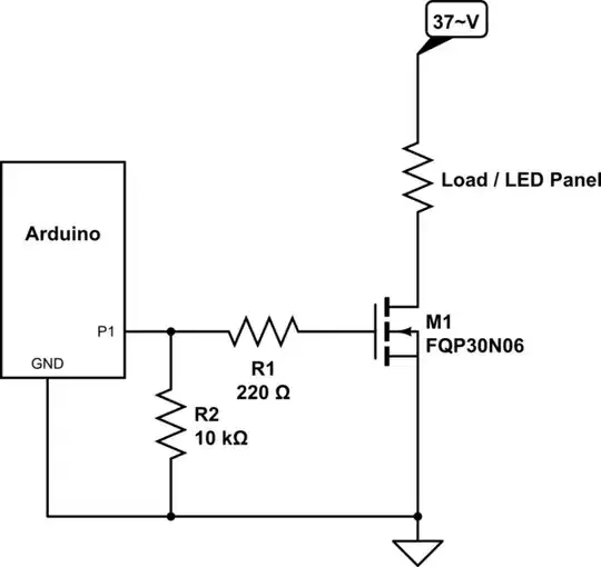

IF your LED Panel draws a good bit less than 200mA (say 100mA~150mA), I'd suggest the following:
1 - As per datasheet 2n3904 hFe is minimal 30 (in practice more). In Ib = Ic/hfe, we get:
Ib = 150mA/30 = 5mA
2 - VBE max at closest match (50mA) is 0.95V, say 1V (in practice less).
So 5V - Vbe = Rb * Ib, gives ~4V = Rb * 0.005mA
Rb = 800R
3 - Schematic:
schematic
Note that you get uncomfortably close to 2n3904 limits: Vce 40V, Current 200mA, etc..
So I'd actually suggest the following:
schematic
simulate this circuit
I just used this particular mosfet because its available at Sparkfun and gives better margins (60V, 30A). You can use anything that suits your needs. (R2 optional)

  • Thank you very much for the answer. Quick question, what does 'Load' resistor mean? also, what if my LED panel draws more than 200mA? will that burn my Andurio? Thanks! – user3578847 Apr 12 '16 at 00:15
  • I used a resistor but it represents your load, the LED Panel. If it draws more than 200mA your transistor will possibly have a VERY short and unhappy life. I'd use the second option. – Wesley Lee Apr 12 '16 at 00:18
  • With second option using two resistors, I can be 100% safe? – user3578847 Apr 12 '16 at 00:23
  • 100% safe is very hard to guarantee, I can say that it ~can~ be very durable. If you are really worried take a look into some simple techniques to protect MCU pins, such as clamp diodes, etc – Wesley Lee Apr 12 '16 at 00:31
