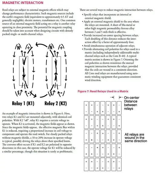

The magnetic field of one relay coil could affect the one next to it.
For example, it could actuate the relay next to it, or affect the vibration resistance, or it could decrease the drop-out voltage.
Since adjacent relays with the same polarity drive will have fields that oppose, it can also increase the pull-in voltage, if they are driven the same way.
More in this application note from Coto (a major and old-line manufacturer), I've reproduced the relevant page below, but there is plenty of other good information in this document.

    If one relay is pulled in, you could tap the board and have the ones on either side actuate. Or maybe they'll both just pull in (especially at low ambient temperature where coil current is higher). – Spehro Pefhany Apr 10 '16 at 18:28
    You mean the magnetic field in one relay could flip other, adjacent relays? Or do you mean that the relays will physically pull together? – dpdt Apr 10 '16 at 18:31
  • Magnetic....!! If its contacts are reed type, they are made from silver plated mild steel and they are sensitive to the stray magnetic field, unless the body is ferric-shielded. Thus operating one relay at close proximity to another might cause the other relay fails to close or open at the specified parameters. – soosai steven Apr 10 '16 at 18:32
    The first is what I mean. – Spehro Pefhany Apr 10 '16 at 18:32
    There may be some applications where this would not be a problem. But you are being warned that you need to be sure. – gbarry Apr 10 '16 at 19:20
    Right, it probably won't break noticeably at 0.45", but you ignore the manufacturer's engineering recommendations at your own peril, and I've pointed out some subtle ways the relays could interact before they literally pull in together. – Spehro Pefhany Apr 10 '16 at 19:26
