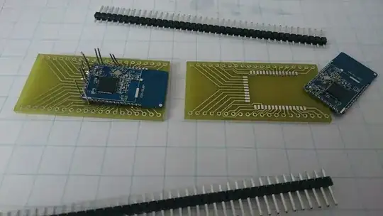

I have made a costum PCB with components and a WT51822-S2 bluetooth module. After testing, there seems to be a low percentage of modules that have a fault in them. Since they are SMD modules, with connections on the sides, its hard to desolder them if faulty. They are soldered on easily with a normal solderin iron but desoldering, thats a whole other thing.
Is there a way to test SMD modules without actually soldering them on the pcb? I have tried pressing them on (with force and duck tape) but some pins have contact, others dont. I have also made a brakeout board for testing, but it still requiers soldering.
what to do?

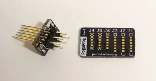

You need pogo pins like the ones used in this programmer board: enter image description here
There are many manufacturers of such pins.
Another useful term to search for is "bed of nails."
That together with pogo pins should get you all you need to know.
Get some pins, build a board to hold them, arrange the pins so that you can press your board to test into the pogo pins, do your test.
You might consider a mechanical hold down to keep the test board in place if you have a bunch to do.
