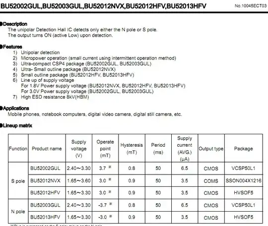

Majenko suggested reed rather than hall switches. They have good (zero off current) and bad points (somewhat fragile, may have minimum wetting current) , but you can get strobed Hall cells with say a 100 mS or even 50mS inter- wakeup period
A nice examples is ROHM's BU520xx series of ultra low current Hall switches with 3.5 uA mean current draw and 50 mS inter-wakeup periods.

  • The decision may actually depend on if one state (open or closed) overwhelmingly dominates, or if they are comparably frequent. If comparable, the current draw of a pullup resistor shorted to ground via a closed reed switch will likely exceed that of this self-interval-polling sensor. If unequal, choose an NC or NO reed switch so the switch is closed only in the less common state. – Chris Stratton Nov 23 '11 at 21:37
