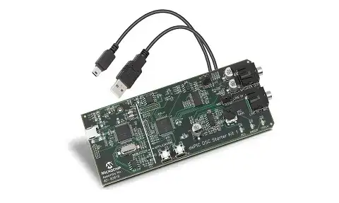

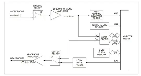

For $60, you can buy a "DM330011-MPLAB Starter Kit for dsPIC DSC" which combines a dsPIC (essentially a PIC24 with added DSP instructions) with a codec..
It is described as:
"This Starter Kit introduces users to the dsPIC Digital Signal Controller device using its speech and audio processing capabilities. The kit is USB-powered, has on-board debug circuitry and 24-bit codec for high-quality audio applications."
