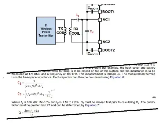

Particularly when using an analog IC, there will typically be one or more suggested application circuits in the datasheet. For example, I am currently designing a Qi receiver for a project. The capacitors in the inductive loop are dependent on a number of variables, and the datasheet provides some equations for determining their values:
So it is just a matter of plugging in the numbers, breadboarding the circuit and trying it out.
