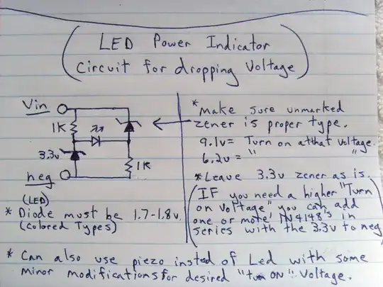

I'm thinking it should be a simple circuit, solar panel→batteries→Vin & GND (5V regulator is built in, of course). But if the low voltage while charging and dying off is a problem, I was thinking about using a low-voltage indicator circuit to tell when the power drops below 6.5-6.9V:
Hand drawing:

and some logic gates, maybe a NOT gate and replacing the positive side of the LED from the circuit above with the input for the NOT gate, with the output going to Vin. Hopefully a transistor NOT gate can withstand the 7.2V.

  • if I understand correctly you're planning on completely draining the batteries every night, until your circuit fails. This will deep discharge your batteries, which they won't like and lose capacity very fast – Christian Apr 01 '16 at 07:51
  • Then I will probably include the low voltage circuit to stop them from completely draining – Gᴇᴏᴍᴇᴛᴇʀ Apr 01 '16 at 15:54

Instead, you should use a battery charging circuit. Many off-the-shelf boards can be found at online & local electronics shops. Eg This battery charger from Sparkfun. Some of these boards turn off the voltage when the battery voltage gets too low - to prevent damage from over-discharging the battery.
I would also be cautious about having an LED indicator for when the battery is low. This will drain the battery even further and can damage the battery if it over-discharges. Instead, have a LED on if the battery is OK - although this will cause the battery to drain quicker.

  • What do you think of the circuit I was thinking about building to turn off the Nano when the voltage was too low? (last paragraph) – Gᴇᴏᴍᴇᴛᴇʀ Apr 01 '16 at 16:02
  • I would measure Vin (through a voltage divider) using one of the Arduino analog inputs. I would then have the Arduino turn on the LED when it was above/below a certain threshold. If you pulsed the LED output, the LED would consume less current as it is only drawing current during the ON phase of the pulse. – sa_leinad Apr 01 '16 at 16:32

The only weak point of your project is the regulator: zener diodes typically need to sink about 5 mA to work properly. Personally I would avoid the regulator altogether and power the Nano by 3 NiMH cells: I'm quite sure Atmel chips can cope with voltages in 3.6-4.5V range without any regulation. Incidentally, you can also use a cheaper and less powerful solar panel for this project.
