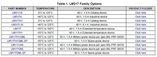

Sometimes this is simpler than others. Here's a small subset from the LM117/317 family of parts: LM317 family
You can see that they have different temperature ranges and certifications. The 117 series can handle tougher operating conditions for military and aerospace applications, while the 317 is more for consumer and industrial applications. LM meant National Semiconductor until they were bought by TI a couple years ago.

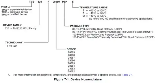

The TI microcontrollers I work on have a more complex numbering scheme. Here's how the part numbers break down for the TMS320F2806x series:
2806x part numbers

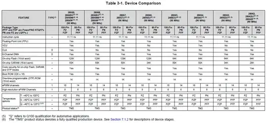

The different device numbers have different functionality available (and different prices). Here are some of those differences:
2806x device comparison
It isn't always this complicated. Some ICs have only a single variant. But usually there are at least a few different packages available.
