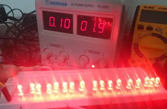

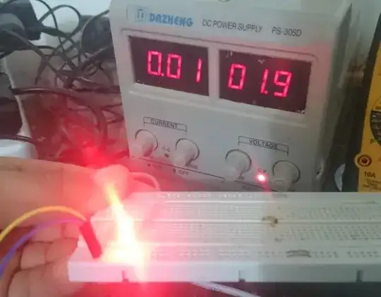

In theory if one LED consume 10mA so 17 parallel LEDs consumed 170mA, but in reality when i connect 17 parallel LEDs they only consumed 100mA not 170mA why there are difference between theory and reality? power consumption of one LED power consumption of 17 LEDs

  • Note: The intensity of the light recorded in the image is visually greater in the set of 9 to the left of the bridging jumpers in the center of the power rails. This makes it nearly certain that Passerby's point of there being resistance in your setup and a drop in the voltage between your power input and, at least, the second set of LEDs. – Makyen Mar 14 '16 at 07:16

Your PSU meter is only has resolution to 0.01 A (10 mA). The actual current could be anywhere between 5 mA and 15 mA for the single LED.
Switch your yellow multimeter to mA range, connect the leads into the correct sockets and wire the multimeter in series with the one LED and get a more accurate measurement.
Paralleling LEDs in this fashion is not recommended. The ones with the lower forward voltage drop will hog the current. Either connect them in series with a current limited supply or put a resistor in series with each LED to limit the current.

You are assuming that each of these leds have perfectly identical IV curves. The stated specs are nominal, typical figures, and there will be variations.
One LED may be 10mA at 1.9 VF, but another may be 8 or 12 mA or different at the same VF. That's not even taking brightness into account. Two leds with the same IV curve can be noticeably different in color and brightness too.
You also have to account for your supply's precision or rounding. It only measures to the 100th of an Amp. Not enough for proper single milliamp range.
Also take into account the resistance of the breadboard you are using. If you measure the voltage across the first led and the last led, you may notice a difference.
You should use a good ammeter or multimeter in current mode, and individually measure each of the leds in this circuit to see how much each led is actually consuming.

The simple answer is rounding error with only "1 significant figure" in 0.01 A which ought to read 0.0058 A
But you can now compute the current 100/17=5.8mA per LED due to lack of 3 significant figures from a single LED reading.
Furthermore you can predict the current rise with voltage rise. Nominal 5mm Ultrabright LED has internal ESR of 15 Ω. With 15 LEDs in //, the ESR would be ~ 1Ω. ( & 17 slightly less.) Thus every precise rise of 0.10 V results in a rise of ~0.10A which suggests the "knee" of the Vf curve is 1.8V, where ESR rises dynamically.
To safeguard against mismatched ESR in LEDs, I recommend adding a minimum of 50% of the ESR or 8Ω approx when driving them to max in parallel.
This affects Vf vs If and can have a narrow tolerance <1% from a single batch or wide tolerance on the high side from mixed batches. ergo this affects current sharing and only becomes significant when self heating reduces the Vf. This difference is accelerated with rising current above 20mA especially where the internal threshold voltage reduces (Shockley Effect) thus the voltage across the internal ESR bulk resistance rises and draws more current from the supply's constant voltage.
