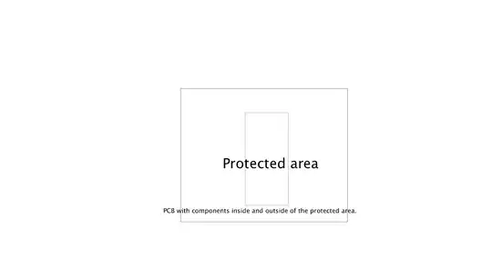

I like to protect a sensitive circuit of mine with a shield. I don't have a picture but basically, I have put together a 1 mm thick ground rectangle on the top layer, and I will place the shield on top of this such that it will contact to this ground trace.
I have some concerns.
  1. Am I creating a ground loop by doing this?
  2. If I don't use the shield, am I making an antenna that will pick up noise?
  3. What is the recommended practice for this type of shield?
Actually, I like to connect the shield at a single point, but a hardware person who has more experience insists that he like to have a full rectangular ground exposed, so that the shield can touch to the ground at every point.
Update
Enter image description here
Here is a very rudimentary representation.

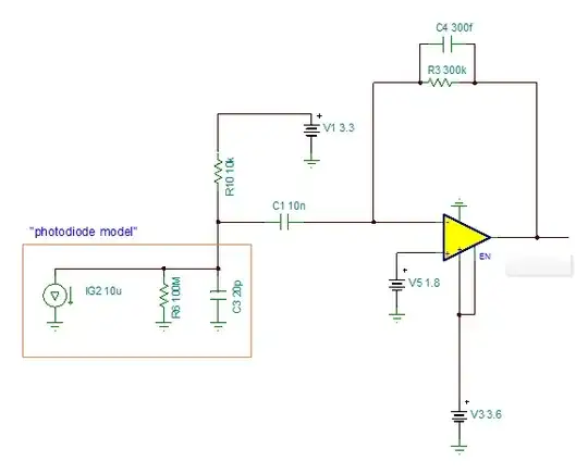

UPDATE 3
  • 3-5 mV exists even without the 10K and the C1. Essentially no input to the opamp. This makes me think that my layout is not perfect.
Here is the basic schematics for the amplifier. I can add more if we think it is necessary.
Schematics
The following rules have been observed:
  • Complete two ground layers connected via several vias.
  • The 3.3 V supply (also the supply for the opamps) are filtered via a 2.2 µF tantalum capacitor and the pi network (100 kHz roll over) before the supply to the photodiode (that is, before the 10K resistor). We also have 1/100/10 nF capacitors close to the 10K. (I am not sure it is great idea, but it is better to be safe.)
  • C1 blocks the DC (AC-coupled architecture), we only amplify AC.
  • Opamp has 1/100/10 nF at supply and bias pins (bias is provided by the second LDO).
  • The feedback capacitor and resistor are placed as close as possible to the opamp.
  • All signal traces between the photodiodes and opamps are minimized; we are talking <2 cm worst case.
  • All the critical deemed signals are placed between two ground layers.
Also another observation that explains why we think of shielding: I connect a resistor to our function generator and turn on, this is via crocodile cables, (essentially a loop antenna) so we know it radiates at the frequency we choose. I can see the output of opamp picking this up nicely and amplifying. So, it is very clear to me the outside sources come in to play, hence the whole discussion.

When I first hear someone wanting to use a shield, I start out by saying a shield is the first refuge of the incompetent. That's not totally fair as there are legitimate uses for shields, but it sets the tone for the real discussion, which is usually about RF emissions or susceptibility and ultimately about bad grounding that is causing the mess.
A shield should be the last refuge of the competent. Shields also have significant downsides, beyond the obvious cost issue. The incompetent believe in the myth that if you enclose something in a conductive box that RF energy can't get out or come in. That's absolutely not true. A shield can also become an antenna if not designed properly.
Before we can talk about your shield, we first have to go over your grounding strategy carefully. Shields and grounding go together tightly. Explain what exactly the problem is you think the shield will solve, how exactly everything is grounded, what the sources of noise are, etc.
In general, good grounding will do more to reduce RF emissions and susceptibility than a shield. If the grounding is done right, a shield can add some extra attenuation of emissions. If the grounding is done wrong, the shield could become a antenna and make things worse. With a good ground, you generally want the shield enclosing the circuit with as few and small holes as possible, connected to the main circuit ground in exactly one place.
Again, tell us more about your circuit, layout, and problem. Then we can discuss more about the shield if it's still appropriate.

Added after update 3:
3-5 mV exists even without the 10K and the C1. Essentially no input to the op-amp. This makes me think that my layout is not perfect.
That tells you the noise is not coming from the photodetector, so you can forget about that for now. The noise is either on the bias voltage for the positive input or is on the ground.
Again, I don't think this is a good idea for two reasons. First, these two planes need to be regularly stitched together. That's not as easy to do right as it sounds. Second, it sounds like you therefore didn't use sub-ground for critical subsystems. Part of the point of these sub-grounds is to isolate the high frequency loop currents to keep them off the main ground. By attaching each sub-ground to the main ground in only one place, it keeps the high frequency loop currents local, and prevents the subsystem seeing offset voltages between different ground points due to currents on the ground plane.
The 3.3 V supply (also the supply for the op-amps) are filtered via a 2.2 µF tantalum capacitor and a pi network (100 kHz roll over) before the supply to the photodiode (that is, before the 10K resistor).
But you don't show any of that. A tantalum capacitor will have poorer high frequency response and higher ESR than a ceramic capacitor. There is really no reason at all to use a tantalum capacitor at this voltage and capacitance. Also, a capacitor by itself isn't much good without some impedance to work against. You mention a pi network, but none of this is shown on the schematic and you only talk about a single capacitance, so that doesn't add up.
As I also said before, 100 kHz is too high. As I said, I would like to see that 10 kHz or less.
Good, but again, they need some impedance to work against. A ferrite bead chip inductor in series with the supply feed would do that, as I said before.
Op-amp has 1/100/10 nF at supply and bias pins
OK, but once again, these need some impedance to work against. A chip inductor in series would help.
Also, again, where exactly do these capacitors connect to the ground? I suspect you are just punching through to your ground planes. Again, this should all be connected to a local ground net connected to the main ground plane at a single point.
The feedback capacitor and resistor are placed as close as possible to the op-amp.
Good.
All signal traces between the photodiodes and op-amps are minimized; we are talking <2 cm worst case
You have already shown this is not where the noise is coming from.
All the critical deemed signal are placed between two ground layers.
Again, this kind of shielding is only useful if you have a clean ground, which I think you don't. If you don't, all this does is increase the capacitive coupling from the noise on the ground to your signal.
