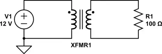

You're probably wondering why your Falstad circuit seems to work. The problem is not with the simulator. CircuitLab shows the same behavior.
This happens under the following conditions:
- The DC source is ideal (no resistance).
- The transformer is ideal (no loss or primary-side resistance).
When you apply a voltage to an inductor, the current increases over time. If there's any resistance, the current will eventually level out (DC), at which point the inductor does nothing. But with no resistance, the current can rise forever.
In an ideal transformer, this endlessly rising current produces a DC voltage and current on the secondary side. So ideal transformers do work at DC. But there's no such thing as an ideal transformer. Add a small resistance like 0.1 ohms between your voltage source and the transformer, and you'll see the secondary-side output decay pretty quickly.
