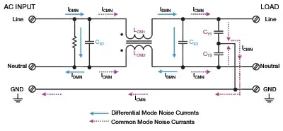

Below is a typical schematic of an AC/DC power supply EMI filter.
You can see that the X-capacitors (between line and neutral) plus the leakage inductance of the common-mode inductor give the differential-noise rejection, and the CM choke inductance combined with the Y-capacitors give the common-mode noise rejection.
I would also not be surprised if the output return is directly connected to earth.

  • Usually I've seen the capacitors to ground on the line side of the balun, not the device side, but this still illustrates why the ground line is needed. I don't see a point to the input resistor though. – Olin Lathrop Nov 09 '11 at 22:41
    Resistor is probably to discharge the 3 parallel capacitors if the unit is unplugged at Vpeak or near it. Depending on electronics or load involved it may be possible to have no load so caps stay charged. Touch input pins sand get a moderately unpleasant shock. I've actually seen (and felt) equipment where this happened. One example was a torch that charged offline using a series capacor transformerless power supply. Touch the mais pins soon after charging and ... !!! – Russell McMahon Nov 10 '11 at 02:26
    Great, but is that EMI stuff necessary? I've seen may power bricks of more or less the same power and most of them accept a two-wired cable. – sharptooth Nov 10 '11 at 11:45
    IIRC, US and Canadian safety standards dictate that any capacitors across the line have to discharge within 30 seconds of removal of the AC. The resistor provides this path. – Adam Lawrence Nov 10 '11 at 15:02

Madmanguram's diagram and comment should be noted.
Madmanguram has provided an excellent illustration.
Note the comment re output return also being grounded. This IS sometimes done and, when it is, is an utter disaster when the ground lead is not grounded eg a 2 wire cord is used.
Local ground = capacitor centre tap is now at half mains wrt true ground. ie about 115 V on a 230VAC system. The whole supplied equipment floats at half mains above ground. The two caps are typically 0.001 uF each so impedance is as of 2 caps in parallel .
Z~= 2/(2.Pi.f.c) or about 5 megohm giving leakage currents of about 10 to 20 uA. This does not sound like much but produces annoying "bites" on fingers etc when touching Vout while ones body is grounded - due to voltage level - and happily charges up stray capacitance to have enough energy to blow things up - which definitely does happen.
The solution is to ground the ground lead.. BUT
Worst is when manufacturers connect centre tap to output negative and then do not make allowance for using a ground conductor. You get half mains floated equipment and no easy way to fix it. A nasty result which needs running or using a ground connection outside the power cord.
