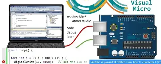

Plugin Image
(source: visualmicro.com)
The free Microsoft Visual Studio and Atmel Studio Plugin is simple to use and has all of the useful features of the Arduino IDE.
Sketch code remains fully compatible with the Arduino Ide. The plugin uses the same build process and tool chain as the Arduino Ide. You choose which Arduino Ide version(s) you want to use with your projects.
Provides many additional features such as drill down into compiler errors, disassembled view (with drill down), code completion, upload via programmer or Usb.
Supports multiple Arduino versions in a single Ide. The Visual Studio version also supports the Intel Galileo.
Both Ide's support Arduino Yun Wifi/Web Server upload. There is also an optional Usb/Serial/Wifi Arduino Debugger
Atmel Studio is based on Visual Studio. Atmel Corp. are the company that make the Arduino micro-controllers. This means the Atmel Studio Ide is aware of and made for the Arduino micro-controllers.
Atmel Studio also provides other tools such as a Simulator.

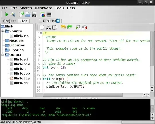

Personally I recommend (since I wrote it ;) ) UECIDE. It was originally based on MPIDE for the chipKIT boards, which itself was based on version 0023 of the Arduino IDE, but there's not much of the original code left now, it has all been re-written.
It supports all the Arduino boards, plus chipKIT boards, Launchpad, Maple, and a whole host more.

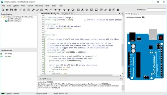

PROGRAMINO IDE for Arduino is my product.
It is a commercial alternative low DIY budget pricing IDE for Arduino, Genuino or similar boards with Code-Autocomplete, Custom Syntax Highlighting, analog Plotter, Hardware Viewer, HEX-File extraction, HTML5 Editor and in the feature with Debugger and more. The IDE for Arduino is easy and comfortable to use and fully compatible with the original Arduino IDE. Uses the original build tools from Arduino to compile and upload your code with the arduino command line function. You can use different Arduino Versions to compile your Project.
PROGRAMINO IDE - Hompepage
