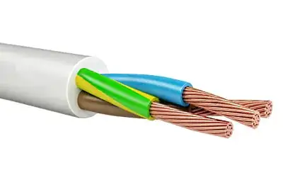

Just made some real-world measurements.
So I take the cable like this:
The specs are the following:
  • 7 conductors in each wire
  • each conductor 0.35mm in diameter
  • 0.67 sqmm wire section
  • 2mm wire with insulation outside diameter
  • length of the wire is 20.3 m
The RLC measurements are the following:
  • 14 uH for two wires (connected on the other end)
  • 1.4 Ohm for two wires
  • 1000 pF (two unconnected wires)
The wire was formed in a bundle with 27 cm average diameter (if it's meters).
