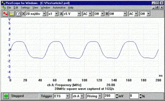

As for bandwidth. The Nyquist criterion states that the sampling rate should be at least twice the frequency you want to measure. But even at twice the rate, it is terrible at best. Consider the following pictures:
The graph captions tell the story. You need to exceed the specified bandwidth by a great amount in order to gain an accurate representation of the square wave input signal (high frequency harmonics). And greater bandwidth = greater cost.

    Well, the linear interpolation doesn't help.. – endolith Nov 08 '11 at 23:03
    "by a great amount" is quite wrong - by 2x precisely, that's what's important about the Nyquist criterion. – James Nov 08 '11 at 23:59
    @Autopulated, I cleared it up for you. Nyquist is still correct but I was specifically referring to that square wave. You would need an infinite bandwidth to capture it perfectly so we are loosing information and cannot sample all the higher order harmonics as our sample rate is bellow their respective Nyquist rates. – Konsalik Nov 09 '11 at 00:17
    A 20MHz square wave has harmonics much greater than 20MHz. So isn't using a nyquist frequency of 40MHz for a 20Mhz square wave not correct? What happens when you use a 20MHz sine wave instead? – Doc Nov 09 '11 at 14:26
    @Doc: In most application domains, perfect sine waves are the exception rather than the rule. If one were to sample a 19.9MHz sine wave at 40MHz, and then pass the reconstructed wave through a 19.91MHz brick-wall low-pass filter, one would get back the original 19.9Mhz wave. Without a reconstruction filter, one would see a 19.9MHz wave superimposed on a 20.1Mhz wave, which would appear as a 20Mhz wave ring-modulated at 100KHz. Note that scopes generally do not have perfect filtering, both because it would be expensive, and because ... – supercat Aug 20 '12 at 15:01
    @Doc: ... a brick-wall filter is not always the optimum thing for capturing a wave's "visual" shape. For example, passing a perfect 10Mhz square wave through a 45Mhz brick-wall filter will yield a wave with a fairly substantial dip in each of the areas that should be flat. If one didn't filter the square wave before capturing it at 100MHz, so that each wave was simply high five samples and high low samples, a simple plot of the data points would look more like the original than would a plot of the filtered points, but a brick-wall reconstruction would look much less like the original... – supercat Aug 20 '12 at 15:26
    ...than would a brick-wall reconstruction of the filtered wave, which in turn would look less like the original than would a simple connect-the-dots plot of the unfiltered data. – supercat Aug 20 '12 at 15:30
