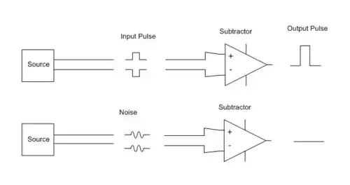

The reason RS-422 is so much better at rejecting interference is because it is what is known as a Balanced Line transmission system.
In a balanced line system the signal is transmitted twice. Once as a normal "positive" signal, and once as a "negative" signal.
Imagine if you will a signal that is made up of the binary digits 01110010 (we will ignore any line-encoding like Manchester, etc).
The positive signal may be transmitted as, for example:
+ 0v  5v  5v  5v 0v 0v  5v 0v
The negative signal could be:
- 0v -5v -5v -5v 0v 0v -5v 0v
At the receiving end these two signals are subtracted from each other. As you know, subtracting a negative value from a positive value cancels out the two negatives and is like adding two positive numbers:
= 0v 10v 10v 10v 0 0 10v 0v
Now, when noise is introduced, because the wires are twisted together, the noise is induced the same into both the positive and negative lines in (roughly) equal amounts. So say there is a spike of +3v noise introduced in the middle of our binary sequence. The new sequence would look something like:
+ 0v  5v  5v  8v 3v 0v  5v 0v
- 0v -5v -5v -2v 3v 0v -5v 0v
So the resultant subtracted values would be:
= 0v 10v 10v 10v 0v 0v 10v 0v
See how the noise has completely vanished.
This same principle is used in many high-speed communications systems, like USB, Ethernet, HDMI, etc.
It is also used in professional audio equipment where a signal from a microphone has to be as noise free as possible - it's not just a digital thing.
