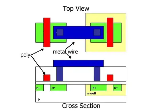

I think you have to look at it the other way around: CPUs are made with steps (implantation, lithography, etching, deposition of materials). If you design the steps and layers a certain way you get a CMOS couple (N-type MOSFET on the left, P-type MOSFET on the right), useful for making inverters and then start the whole logic thing, to eventually build all the CPU logic blocks.
But CPUs need other kinds of devices, for ESD or integration of memory or whatever. For that, you can design the layers in another way and get resistors (using the polysilicon layers or the doped substrate), by making a long line thing of material:
This is the crux of what made planar IC technology such a disruptive idea: From simple steps you can build (almost) anything.

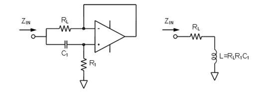

With transistors, resistors and capacitors you can make an opamp which then can be used to simulate an inductor without any coil, with even less area consumed than a real induction coil. Cool, isn't it?
simulated inductor
Above is one of the way to create a simulated inductance. You can find more ways to do that in the below references
Of course if you need more inductance or capacitance you may still have to use a separate external coil or capacitor.
