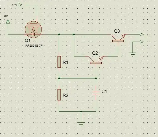

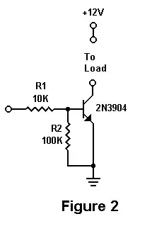

I made a simple transistor switch. I read the theory and in many sources I saw that the load (with an NPN transistor as a switch) is connected to the collector circuit, not the emitter circuit (picture .1, for example.)
Why isn't the load connected to the emitter circuit?
This is my circuit:

    Calculate the voltages involved for both possible configurations and compare – PlasmaHH Feb 25 '16 at 14:29
    Because if you look closely at the math, you will notice that it is giving you $I_c$ as a function of $V_{be}$. Meaning that in order to have a control of the current you better keep the base-emitter voltage known. – Eugene Sh. Feb 25 '16 at 14:30
    In your circuit, what device is meant to be the load? Because really that looks like a circuit designed to test whether MOSFETs or BJTs make a prettier explosion when they fail. – The Photon Feb 25 '16 at 17:22
To make current flow through the base of the transistor, you have to make the voltage on the base about 0.7 volts higher than the emitter.
Connected as you have in the schematic marked "Figure 2," that means you only need 0.7 volts to turn the load on completely.
If you were to put the load between the emitter and ground, though, you would have to drive the base to a much higher voltage in order for the transistor to conduct and power the load.
Since the voltage across the load can vary, you can never be sure just how much voltage to put on the base to make the transistor conduct. You can also never be sure just how far you've "turned the transistor on." If you were trying to make an amplifier or motor speed control, it would be difficult to control the output since would depend in part on the load.
Another thing to consider is that if you are using a 5 volt signal from a microprocessor to control the transistor, then you might not be able to drive the base of the transistor high enough if you are using the transistor to switch a 12 volt load in the emitter circuit.

  • Thank you, but I want to realize soft-start circuit for laser diode, so any voltage variations are not important for me. I updated my question and my circuit are presented there. – amste_av Feb 25 '16 at 14:56
