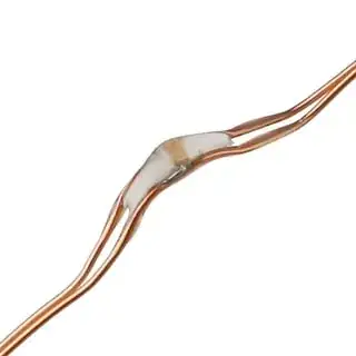

Case in point, USB or Battery powered led strings, fairy light, are all wired in parallel and they work. And they are limited by a single resistor. If multiple go out then they may have issues with over current, but you are using a resistor that will limit the current to safe for even just one (Well, 30mA is higher than a standard 20mA, so life will be shorter by some unknown amount).

  • Yep, I have some cheap solar Li-Po battery strings that are all in parallel (me = horrified) and yet they work. Though the one the squirrels got ticked off at has been VERY bright since it was shortened (by teeth of said squirrels) to about 6 lights from 30 or so. But yet to burn out, so I presume they had LOTs of margin in the design. – Ecnerwal Feb 25 '16 at 03:07
  • @Ecnerwal not only that, these leds are super bright. I got a pair of 5 running on 2mA and they still put out a non-trivial amount of light. – Passerby Feb 25 '16 at 03:10
