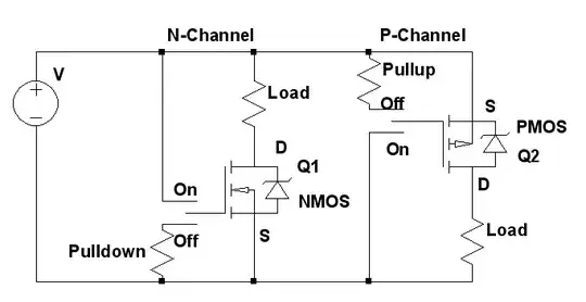

You might not need a MOSFET. You should measure how much current your servo uses when you are not sending any pulses on the signal line. I imagine that a well-designed servo would go in to a deep sleep mode and only use a few hundred micro-amps, but I've never tried this.
If you do need a MOSFET, I recommend using a P-channel MOSFET on the power line of the servo (the middle wire). You can connect the gate of of the MOSFET to the power supply through a 10-100kOhm pull-up resistor to guarantee that it is off by default. Then use a microcontroller IO line to pull the gate low when you want the servo to be powered, and then make the IO line be a high impedance input when you want to cut servo power.
Your circuit diagram should look like the right-hand side of this diagram from reemrevnivek (just look at Q2) Diagram of how to use MOSFETs from reemrevnivek:
In this case, the "load" on the right-hand side is your servo.
You'll want to look at your MOSFETs datasheet to make sure that the leakage currents are not too bad.

    Anyone who upvotes my answer should upvote reemrevnivek for making this diagram! http://electronics.stackexchange.com/questions/3599/basic-p-type-mosfet-question/3604#3604 – DavidEGrayson Oct 23 '10 at 21:25
    Servo may be inductive, so you should add diodes to protect the MOSFETs – Jason S Oct 24 '10 at 13:52
  • I always use these: http://www.physics.udel.edu/~watson/scen103/mos4.html http://www.physics.udel.edu/~watson/scen103/mos5.html – endolith Oct 24 '10 at 14:00
  • Thanks for the upvotes, but the diagram was the work of two minutes in LTSpice. Which, by the way, would be a great tool to help simulate this problem. Also, the link points to my answer for questions about the basics of using a MOSFET, which might be relevant. Jason is right, this was a generic diagram, and didn't consider highly inductive loads like servos. – Kevin Vermeer Oct 24 '10 at 22:49
