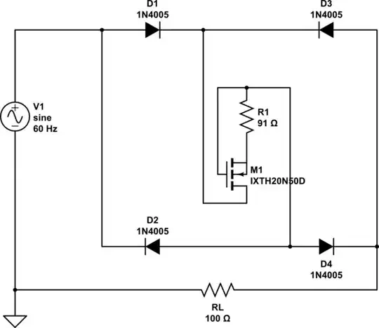

The simplest way to build an active AC constant-current source takes only 4 parts:
  • A suitably rated bridge rectifier (600PIV, 1A works)
  • A suitable resistor (you'll have to try several values)
  • A HV depletion MOSFET such as the IXTH20N50D
  • And a bit of heatsinking -- the FET dissipates a fair bit of power
Theory of operation: This is your standard JFET constant current source, just bigger thanks to the power depletion MOSFET. AC operation is provided by connecting it to the DC terminals of a bridge rectifier. (RL is a sample load -- whatever load you wish just connects in series, the circuit is insensitive to load position and polarity.)

  • That's nice and simple. I presume it will give a squarish wave output rather than a sinusoidal one as it's basically a DC constant current source inside a bridge rectifier. That's probably fine for the application - I doubt the chemicals will notice. – Transistor Feb 27 '16 at 22:34
  • @transistor -- yeah, the output does come out a bit squarish, which might not be the kindest thing on the grid, but for an odd-off like this, it's no big deal. – ThreePhaseEel Feb 27 '16 at 22:57
  • Yes, for this application "squarish" voltage should be fine so long as it's net-zero and running at least ~60Hz. And not a big deal either, but this is substantially less efficient than the op-amp design because we're cooking off double-digit watts regardless of load, right? Can you clarify the output power type? As drawn the load RL is getting 60Hz AC? (Sorry, I haven't been playing EE long enough to understand a circuit without some work.) – feetwet Feb 28 '16 at 00:20
  • @feetwet -- the load still gets 60Hz AC, yes -- and the op-amp design has to cook off the power somewhere too – ThreePhaseEel Feb 28 '16 at 00:25
  • Oh, and by the way -- I was off by a factor of 10 on the current laughs Let me edit this for you – ThreePhaseEel Feb 28 '16 at 00:30
  • So the scaling here is interesting: To provide constant 100mA we're burning 36W, 10mA is ~7W. What's the functional relationship between current, voltage, and waste energy in this design? (I'll try to work it out myself tomorrow; just thought I'd throw the question out there in case it's trivial for you experienced folks!) – feetwet Feb 28 '16 at 03:06
  • @feetwet -- 10mA is indeed 3.6W -- the 7W rating on the resistor is a derate, basically. – ThreePhaseEel Feb 28 '16 at 05:28
  • BTW -- the general concept here is sound -- I can't get CIrcuitLab to cooperate with the design though (the current source is actually wrong way around atm) – ThreePhaseEel Mar 05 '16 at 04:16
  • Thank goodness LTSpice does this right. Here's a simple DC confirmation circuit using the depletion MOSFET you recommended: http://i.imgur.com/2Zl7qXj.png – feetwet Mar 06 '16 at 22:24
