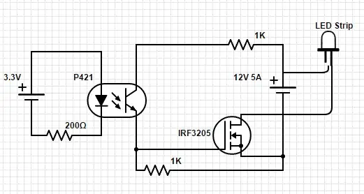

I'm quite new to electronics. I'm trying to power a DC 12V 5A (max) led strip from my raspberry pi. I have constructed a (working) schematic where the main component is a IRF3205 MOSFET controlling the high power circuit.The main problem with this kind of circuit is that the MOSFET becomes really hot.
Schematic of the circuit including a optocoupler, MOSFET and LED strip

The Source-Drain voltage of the circuit as described by the schematic seems to be 0.45V at a Drain current of 1.3 Amps. The Gate has a voltage of 6V or so, but I'm not 100% sure because of my not-always-accurate multimeter.

    Your** fist schematic shows a low-side N-channel MOSFET switch. The MOSFET should be sized such that it doesn't dissipate much heat, and the gate should be driven properly. [**It shows a solenoid valve, rather than LED. That suggests that that's not your actual schematic. Thus, I don't know what you are actually doing.] – Nick Alexeev Feb 17 '16 at 23:22
  • @NickAlexeev I have updated the schematic with the one I am really using (see http://i.imgur.com/Xa2CIVm.png ). The MOSFET has part number IRF3205 (http://www.irf.com/product-info/datasheets/data/irf3205.pdf ). Maybe there is something wrong there? – Bas Feb 17 '16 at 23:53
    What's the voltage at the gate, and the voltage across Drain and Source when on? I'm thinking the gate isn't being driven properly. For one, the 2 1k resistors are forming a voltage divider so that's 6 Volts, and then the opto is being using on the high side? Measure it and reply back. – Passerby Feb 18 '16 at 00:32
  • Thanks for your excellent answer @Passerby . My multimeter had some troubles measuring the voltage between the Source and Drain, but finally decided on ~0,45v. The current of the drain is 1,3A (~1W heat dissipation?) . The gate is being driven at ~6V and 5,6mA. Note that these numbers are not very accurate because my multimeter has some issues. – Bas Feb 18 '16 at 02:00
    That's only 1/2 Watt. In a TO220 package mosfet it shouldn't be getting too hot. http://electronics.stackexchange.com/questions/16882/dissipating-1w-on-a-to-220-without-heatsink The Rds seems to be 0.3Ω, not exactly the best. – Passerby Feb 18 '16 at 02:06
    Try William's circuit, and see how the VDS and ID change, and if it gets equally as hot. – Passerby Feb 18 '16 at 02:09

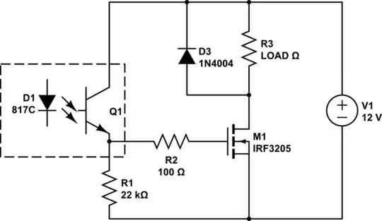

However! The way you have drawn the schematic means that Vgs will reach only about 5V because of the voltage divider effect of your two resistors. The IRF3205 needs Vgs=10V to turn on properly, so your FET will have much higher on-resistance than the datasheet headline value of 0.008R, and this is probably why yours is running really hot.
Try this instead:
schematic
D3 is theoretically not necessary for an LED load, but will prevent parasitic inductance in the (probably-long) LED cables from blowing up the FET when the LEDs turn off.
The cheap little controllers achieve high currents through the use of low-Rdson FETs, as you suspect, and careful heatsinking, usually through copper planes on the PCBs. Just because the outside plastic case feels only slightly warm does NOT mean that the device junction itself is particularly cool.
Edit: interpolating from a dodgy graph in the 3205 datasheet, I suspect that Rdson ~= 1 ohm for Vgs=5V. So your schematic is going to cause it to run incredibly hot and the load will get a lot less power than you expected.

Note: You have a voltage divider of 1k/1k or half of the input voltage. At Best it's 6 Volts at the gate. And the NPN based Opto is switching on the high/middle side, which may bring that down more. Not an ideal setup.
