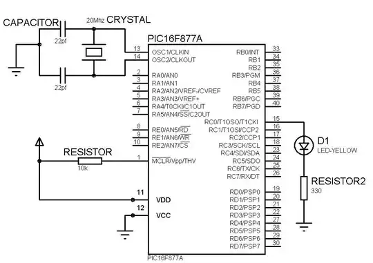

uC circuit:

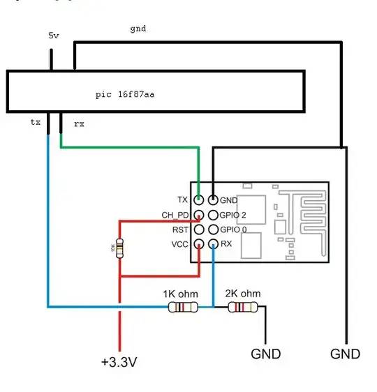

WiFi circuit:
Where will be the problem of current consumption?
Is it wifi problem or ground problem?

  • I think the 1K & 2K resistors formimg a 2/3 voltage divider should be dropping the uC's 5V signal to right at 3.3V, so I'm not sure that's the problem. I somewhat wonder, however, about the possibility of the mentioned problems being supply related. You mentioned having added a second supply to reduce the problem. Is your 3.3V regulator mounted to a sufficient heatsink, or might it still be overheating & not supplying enough power to the wifi module? – Robherc KV5ROB Feb 09 '16 at 06:01

  • @NaveenRaja When I use ESP8266, I keep RST and GPIO 0 pulled up to 3V3 too - I don't see how it works at all unless that schematic is missing those connections. – Roger Rowland Feb 09 '16 at 06:30
  • @RogerRowland gpio 0 will be high only when the module needs to be flashed with the firmware – Honeybee Feb 09 '16 at 06:46
    @NaveenRaja Suggest you double-check that then - everything I've seen either says leave GPIO 0 open or pulled up for normal operation and pull down to flash. I've found my ESP-07 modules work best with it pulled up. In any case, all documentation says RST must be pulled up. If it's floating, it may have something to do with your problem so it's worth checking. – Roger Rowland Feb 09 '16 at 06:57
    Naveen Raja, the Tx of the wifi module is an output @ 3.3v, that hitting the input of your 5v powered uC just means it will be only a little above sensing threshold, but doesn't likely explain the wifi module's overheating. If your problem is happening 'randomly' when starting the circuit, then sometimes gone after restart, I think @RogerRoland is on the right path. Probably a floating pin is setting an incorrect state in the module. Most ICs do not 'like' having their pons left completely floating. – Robherc KV5ROB Feb 09 '16 at 07:18
  • @RobhercKV5ROB Yes, that's what I think - a floating reset pin is not going to do much good if it's oscillating on/off. – Roger Rowland Feb 09 '16 at 07:49

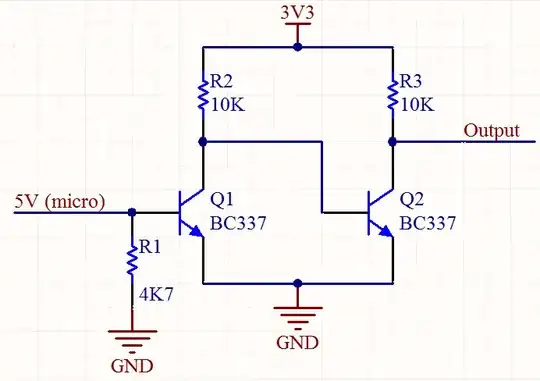

Your micro controller runs at 5V and the WiFi module runs at 3.3V. The RX and TX lines also run at 5V and 3.3V respectively. To use the module in conjunction with the micro controller, you need a level converter which would convert 5V into a 3.3V signal.
To do so, you need to bare in mind that the serial lines (RX,TX) run at reasonably high frequency. For a basic application like this, you can get away with using general purpose transistors. For the circuit below, I have used two NPN transistors BC337.
When a micro controller pin is HIGH, Q1 turns on. Base of Q2 is pulled low, keeping Q2 switched off, therefore, Output is HIGH at 3.3V. Vice versa when micro controller pin is LOW.
This way a 5V signal can be shifted to 3.3V (or any other level).
Did a search on stack overflow, could not find anything close to this description to avoid any repetition. Hope this helps.

  • A single transistor in common-base configuration would be simpler and faster. – CL. Feb 09 '16 at 07:59
  • @CL. could you provide the circuit? – Honeybee Feb 09 '16 at 08:21
  • Single transistor level up shifter. (Downshifting does not even need a transistor.) – CL. Feb 09 '16 at 08:50
  • While your converter is a useful circuit, and can be of use to OP, I'm not sure it anssers for what is czusing their circuit to sporadically overheat & cease normal function immediately after powering up. With that said; using the inverse of this circuit (step up) could improve signal transmission on the WiFi module Tx to uC Rx trace. Might want to add a protective (current-limiting) series resistor to the base of Q1 though. – Robherc KV5ROB Feb 09 '16 at 13:44
