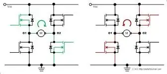

The motor driver board is bidirectional: it uses a transistor arrangement called a H-bridge to drive the motor.
H-bridge
The N-type MOSFETs being used as switches in that board inherently contain a "body diode" as a side effect of their construction. That diode is shown as part of the schematic symbol of the transistors. Normally the transistors will take care of the inductive current, but the body diodes will provide a path for the inductive spikes if something goes wrong with the circuitry that controls the transistors.
If you were to add a diode in parallel with the motor that diode would not only be unnecessary, but it would short out the power supply trough the diode when you reverse the motor.

  • Thanks a lot for the explanation. Where did you see the part about body diodes on this board? – jonathanGB Feb 08 '16 at 23:25
  • They state in the manual you linked "Fully NMOS H-Bridge for better efficiency and no heat sink is required". Practically all powers MOSFETs have a body diode, the reason is a bit complicated but you can read this section on wikipedia. – jms Feb 08 '16 at 23:40
  • @jms MOSFET body diodes tend to be too slow for freewheel diode duties. Additional Schottky diodes in parallel with the MOSFET body diodes are called for. (There are specialized MOSFETs with built-in Schottky diodes, but those are relatively uncommon.) – Nick Alexeev Feb 08 '16 at 23:44
  • @NickAlexeev True, but as I stated the body diodes will not conduct under normal operating conditions, and the board in question lacks external diodes. When the motor is pulse-width modulated one side of the bridge is usually held at either the supply rail or ground and the other side quickly alternates between a conducting high side and low side, allowing the current to flow continously without going trough the body diodes. The body diodes only take a role when the dead time is too long or when the motor is abruptly stopped. – jms Feb 08 '16 at 23:53

    @NickAlexeev: When you say "Additional Schottky diodes in parallel with the MOSFET body diodes are called for.", it sounds like you are recommending that the Orginal Poster somehow additionally attach additional diodes to the board he already has. How do you propose the OP do that? – davidcary Feb 11 '16 at 18:06
  • @davidcary If a motor driver board doesn't have proper freewheel diodes, it's a flaw in the design of the board. Additional diodes can be attached dead-bug style, or however other way one can manage. – Nick Alexeev Feb 11 '16 at 19:00
