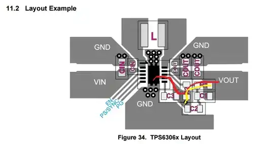

    Are you planning to make the bottom side mostly a solid GND plane? Are you placing components on the bottom side, or all components on the top side? Note that in the reference design, the control GND is connected to the thermal GND pad, but you didn't do that. You should do that. Also note that in the reference design, it is clearly assumed that the bottom side is a GND plane, and this is important. If you are not planning to do that, I think you need to make some changes. – user57037 Feb 08 '16 at 18:47

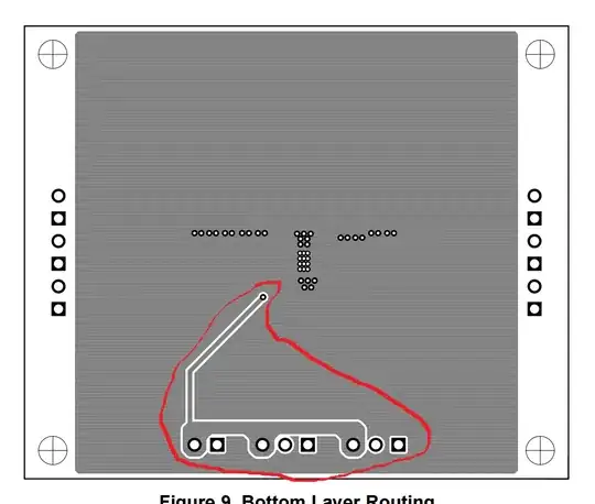

  • OK, so just to confirm, the cluster of vias around C6 and C7 is connected to a plane, or local fill on the opposite side of the board, correct? And the cluster of GND vias near C12-C14 is also connected to the same plane? And the 3 vias between U3 and L1 are also connected to that plane? This is important to provide a relatively short and low impedance GND connection for the high current pathways. I would also suggest that you place "stitch" vias here and there to provide a better connection from any GND on the top layer and GND on the bottom layer. – user57037 Feb 08 '16 at 19:41
  • I agree with @Pål-KristianEngstad. Eliminate the top layer GND copper running between the inductor pads. It is up to you if you want to remove copper on the GND plane directly under the inductor. But make sure all the high current GND vias I previously mentioned are tied together with plenty of bottom layer copper. – user57037 Feb 08 '16 at 19:44

  • @mkeith Ok, thank you. The vias pattern above C6, C7, C12-15 are connected directly to the bottom GND plane. The same with the ones between U3, L1. – Nic1337 Feb 08 '16 at 20:00

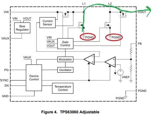

Let's say your ground plane / copper has a resistance of oh, 0.010 ohms (which is stupidly high for a copper plane). In a buck converter, let's say your bottom synchronous switch turns on and current is now flowing through the blue arrows there. With the resistance of the plane (leaving out the inductance here), Ohm's law tells us there's a 50mV drop that will occur. Nearby components that are attached to the ground plane near the path where current is flowing will have their ground perturbed by the current flow (one of the simplest things a designer can do is simply place sensitive circuitry physically separate from high-power areas).
Your part has four integrated MOSFETs -- I've illustrated below the current flow path assuming your device is in buck-mode, and the low-side switch is currently on:

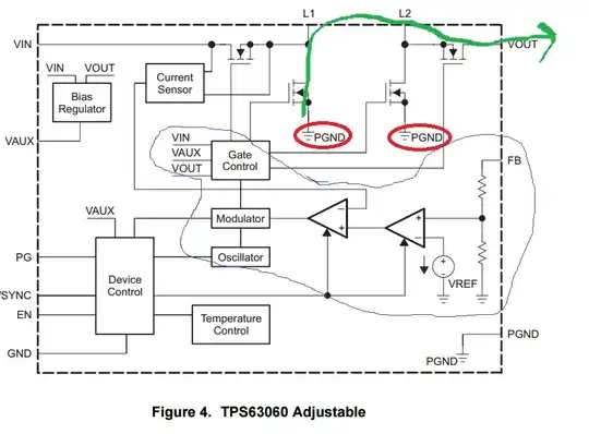

This will perturb PGND (which in the end, is connected with as much copper as possible to your ground plane). However, the feedback amplifiers and gate drivers are going to be referenced to logic ground (the blue areas):
It should not be a particularly high-current path -- the largest current draw there should be the gate drivers internal to the IC. I'm going to change example diagrams here, because I think TI actually got it backwards in their block diagram view (the adjustable version should NOT have internal FB resistors):

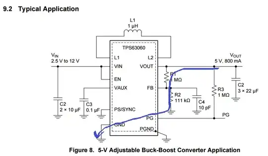

That's it -- a very small current is going to flow through that path to give you your feedback voltage. In their example, as long as all of the small-signal external components (feedback divider and compensation) use only pin 7 of the controller as their return path, and you tie it to GND at one point (like under the controller like they have done), the controller will see the correct potential and 'ride the bronco' so to speak -- as the MOSFETs draw current and switch rapidly, the gate driver + controller is going to be right along for the ride.
So the weird thing to do (IMO), would be to place additional GND vias (like TI seems to have done in that layout example, between C2 and R2) on that return path, because now you've created a potential loop (red vs yellow):
EDIT: I figured out what that via is. It's confusing on TI's part -- it's from their development board: enter image description here
It simply is breaking out the quiet GND to test points on the EVM. So, do not put that via there -- only tie all the small signal stuff to pin 7 of the controller as they have done, following my red current return path. :)

tl;dr -- Run all the small signal feedback components back to pin 7 on this particular controller. Do not pass GO (GND plane), do not collect $200 / ground bounce / multiple loops. Send a note to TI since I think those block diagrams are flipped.
