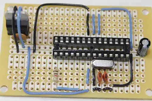

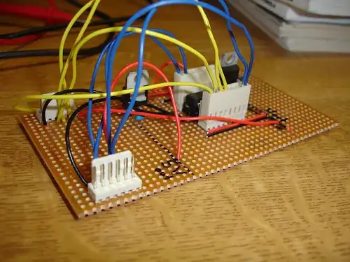

There's veroboard, perfboard and stripboard.
With these, you can either cut tracks or wire wrap.

As others have mentioned, stripboard and similar can be used for quick and reliable through hole prototypes.

It's no solderless breadboard, but I like to use stripboard for this sort of thing. You can secure components with solder relatively quickly, and it saves all the effort and expense of a custom PCB, but it is much harder to fix mistakes than with breadboards.
