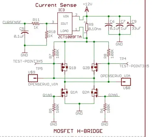

    - Hardware control.
The SparkFun Openservo circuit diagram eferenced below uses the H bridge driver shon below. If the +12V feed at top centre is interupted the servo will not drive. If this feed point is common to a group of servos, all may be turned on and off with ease with a single "switch" (probably a high side P Channel MOSFET.

Circuit of sparkFun implementation.
