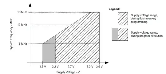

    Brownout aside, the biggest problems are 1, Speed. Higher clock speeds are only supported at higher voltages. 2, a higher voltage on an input, over what VCC drops down to. Potentially fry the pin. – Passerby Feb 02 '16 at 07:43

Running CPU at higher frequency without adequate power supply
The most common problem is that the CPU is set to run at the higher frequency before the minimum supply voltage is reached. This problem occurs if Vcc is ramping relatively slowly than the default code which sets the CPU frequency. This information can be found in the device datasheet usually at the section "Recommended Operating Conditions".
In this case, the workaround would be to create a small delay at start-up before setting up the CPU to run at higher frequency, or to measure the Vcc using internal ADC to make sure that the appropriate Vcc level has been reached before running the CPU at higher frequency.
At Runtime:
Another problem might arise if the CPU is running at higher frequency and the supply voltage drops during run-time. In this case, it is advised to keep the device in reset state as long as the supply voltage drops below the adequate minimum voltage needed for running the CPU at the higher frequency. Failing to do so, the device can't be no longer guaranteed to work properly, and even it could cause severe damage such as flash memory corruption (refer to: MSP430_Flash_Best_Practices).

    @BernhardHofmann there are a few problems with that. Brownout Protection only kicks in if the power supply quickly drops down below a set minimum. A very slow ramp down, like a slowly draining battery will not trigger the BOR. And since the BOR has a minimum voltage its supposed to kick in, it doesn't prevent things like a 16mhz clock freezing or instruction jumping at *RUNTIME* if the voltage drops below 3V. (16mHz not being supported below that voltage). – Passerby Feb 02 '16 at 20:57

The comments nail it. The datasheet should specify a minimum supported operating voltage, likely depending on the clock frequency. If the voltage drops below, likely strange misbehavior is the first observed consequence, followed by intermittent resets and a complete halt later.
